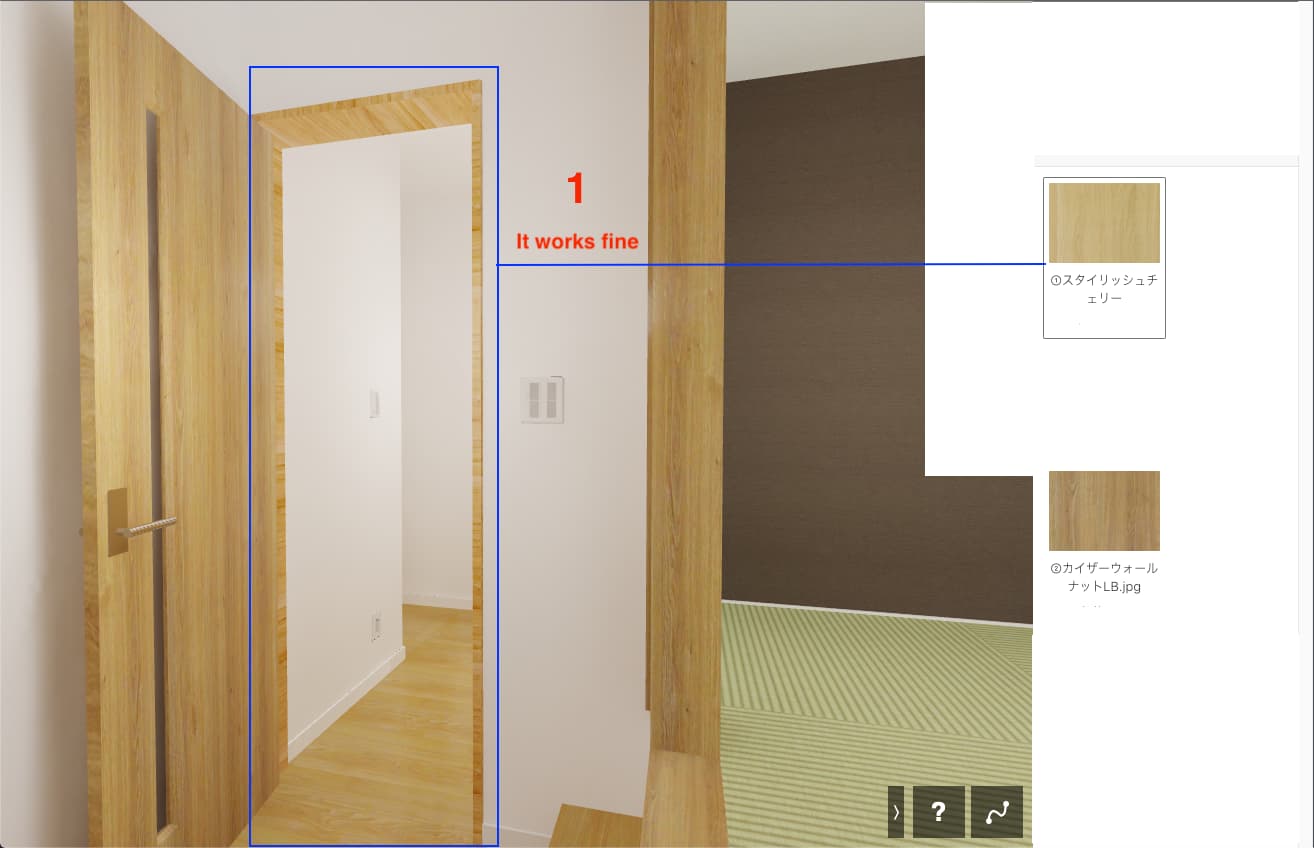

For example:
I have a material named “door border”:
  1. When I change it to “①スタイリッシュチェリー” it works fine (attached: ①.png)

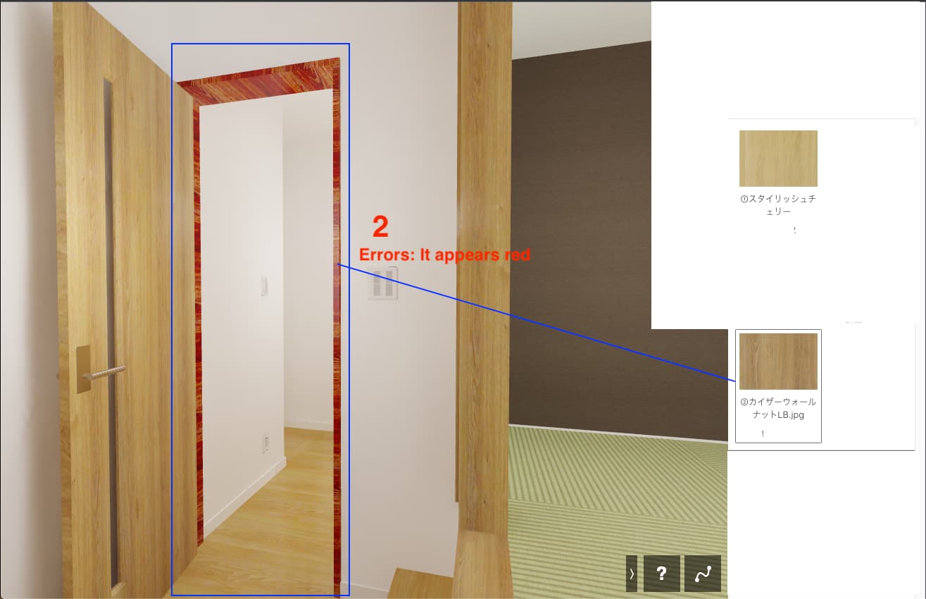

  2. When I change to “②カイザーウォールナットLB” it appears red (attached: ②.png) ==> Do you know why?
Thanks.
Hi, do you have any correction settings for the problematic material’s Base color:
Such settings could cause the color to shift to red.
If not, perhaps texture compression is not handling this particular texture well. You can disable compression with the gear icon:
Uncheck the GPU compressed format checkbox:
After the GPU compressed format setting is changed you need to Upload the scene to apply the changes.
