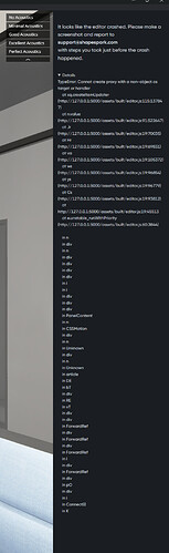

Problem occurs, camera volume trigger crushed when try to set this the trigger in different areas please refer to the detail below
It looks like the editor crashed. Please make a screenshot and report tosupport@shapespark.comwith steps you took just before the crash happened.
TypeError: Cannot create proxy with a non-object as target or handler at xq.createItemUpdater (http://127.0.0.1:5000/assets/built/editor.js:115:137847) at n.value (http://127.0.0.1:5000/assets/built/editor.js:91:522647) at Jr (http://127.0.0.1:5000/assets/built/editor.js:19:70035) at Hr (http://127.0.0.1:5000/assets/built/editor.js:19:69831) at va (http://127.0.0.1:5000/assets/built/editor.js:19:105372) at ws (http://127.0.0.1:5000/assets/built/editor.js:19:96854) at ys (http://127.0.0.1:5000/assets/built/editor.js:19:96779) at Cs (http://127.0.0.1:5000/assets/built/editor.js:19:93812) at http://127.0.0.1:5000/assets/built/editor.js:19:45513 at e.unstable_runWithPriority (http://127.0.0.1:5000/assets/built/editor.js:60:3844) in n in div in n in div in div in div in div in i in i in div in div in div in PanelContent in n in CSSMotion in div in n in Unknown in div in n in Unknown in article in DE in bT in div in RE in vT in div in div in ForwardRef in div in ForwardRef in div in ForwardRef in i in div in ForwardRef in div in pO in div in i in Connect(i) in K
