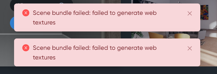

Hi i am unable to bundle a scene which were created in previous version in shapespark 3.3.6.
Can someone please help here.

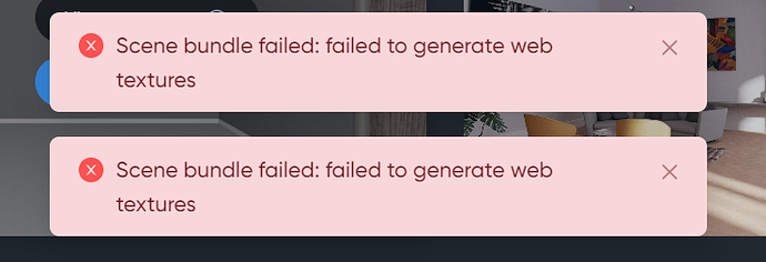

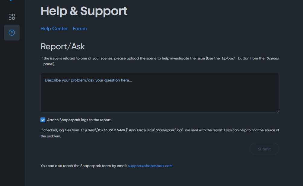

Could you report this error through help&support form in Shapespark? This way we will get the logs from your computer. (Please make sure that the attach shapespark logs to the report is checked)
Also, could you please share your scene with us? Send it to support@shapespark.com
This should help us find out the root cause of the issue you’re facing and find a solution for it.
