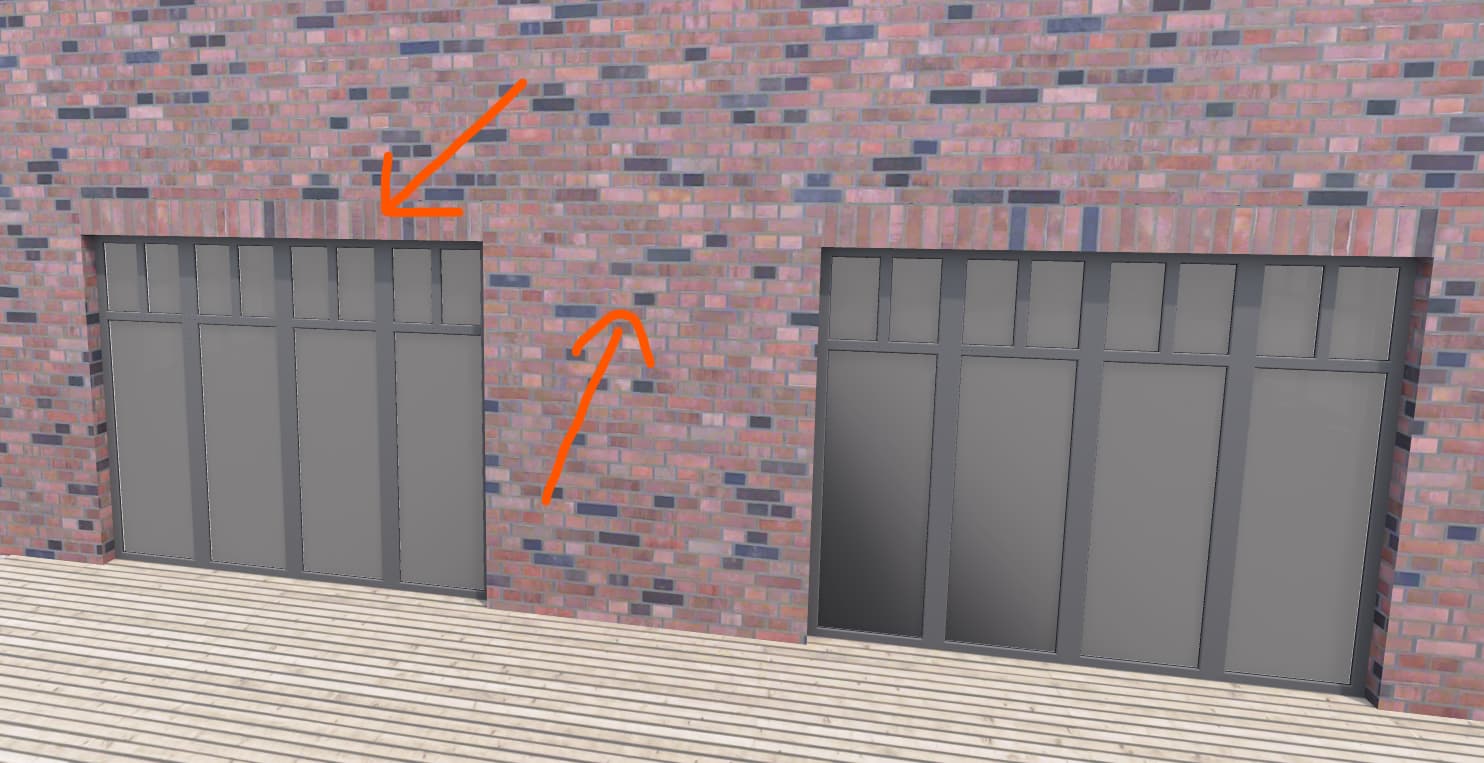

I need to switch the material of the wall and the lintel with one trigger. Is this somehow possible with Shapespark standard tools and no programming? Or can I combine both materials inside of Shapespark somehow?

One option that I see is to have two same objects, but with different set of materials prepared already in the 3D model. You can then in Shapespark use the switch object to switch between these two objects.
