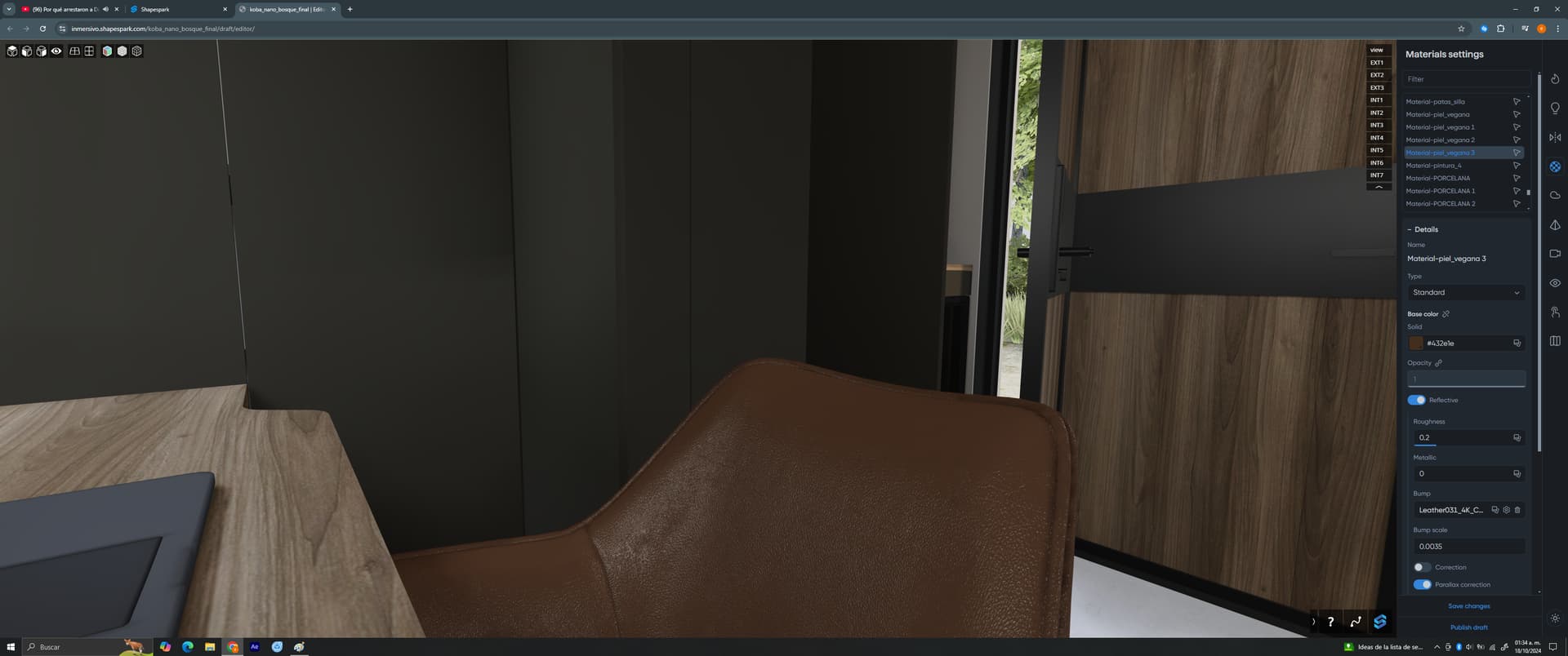

There is some reason why metallic and shiny objects again lose shine and appear dull, everything that has some shine in the roughness channel appears flat and dull.
This happens in the following situations:
  1. Editing in the cloud, then closing the scene to continue editing later, you open the scene again and it has already lost all its shine.
  2. once you finish editing in the cloud, and the draft is published, when you open the already published scene, the same thing happens, it loses all the brightness and realism that could be seen when it was being edited

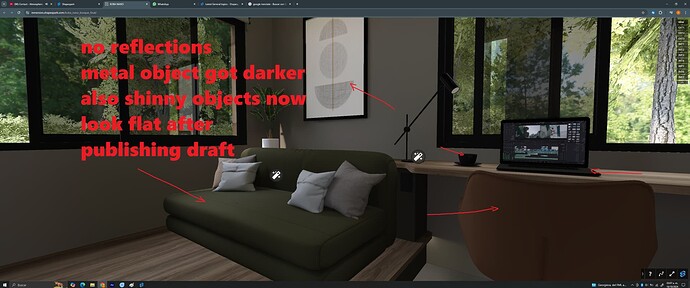

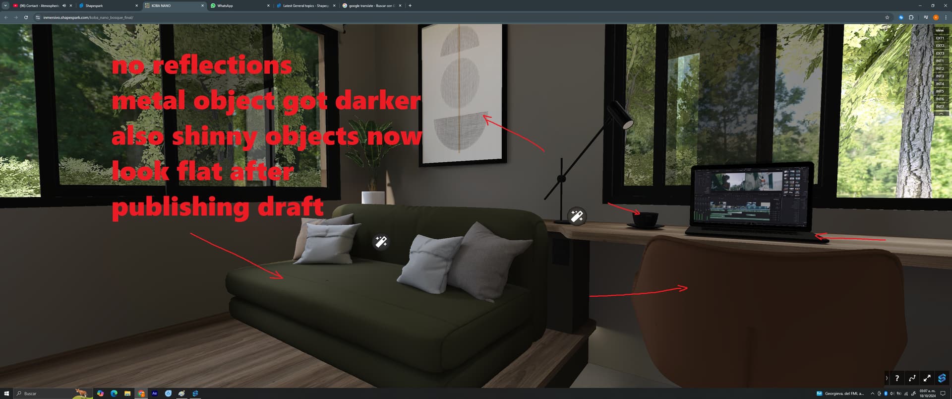

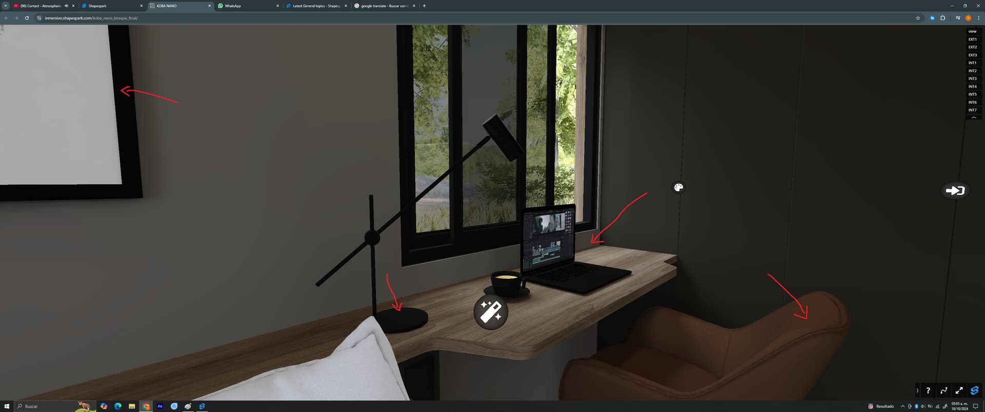

I attach images of the quality of the scene while editing in the cloud and images of the scene once published,
please help me

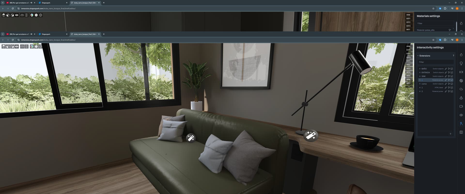

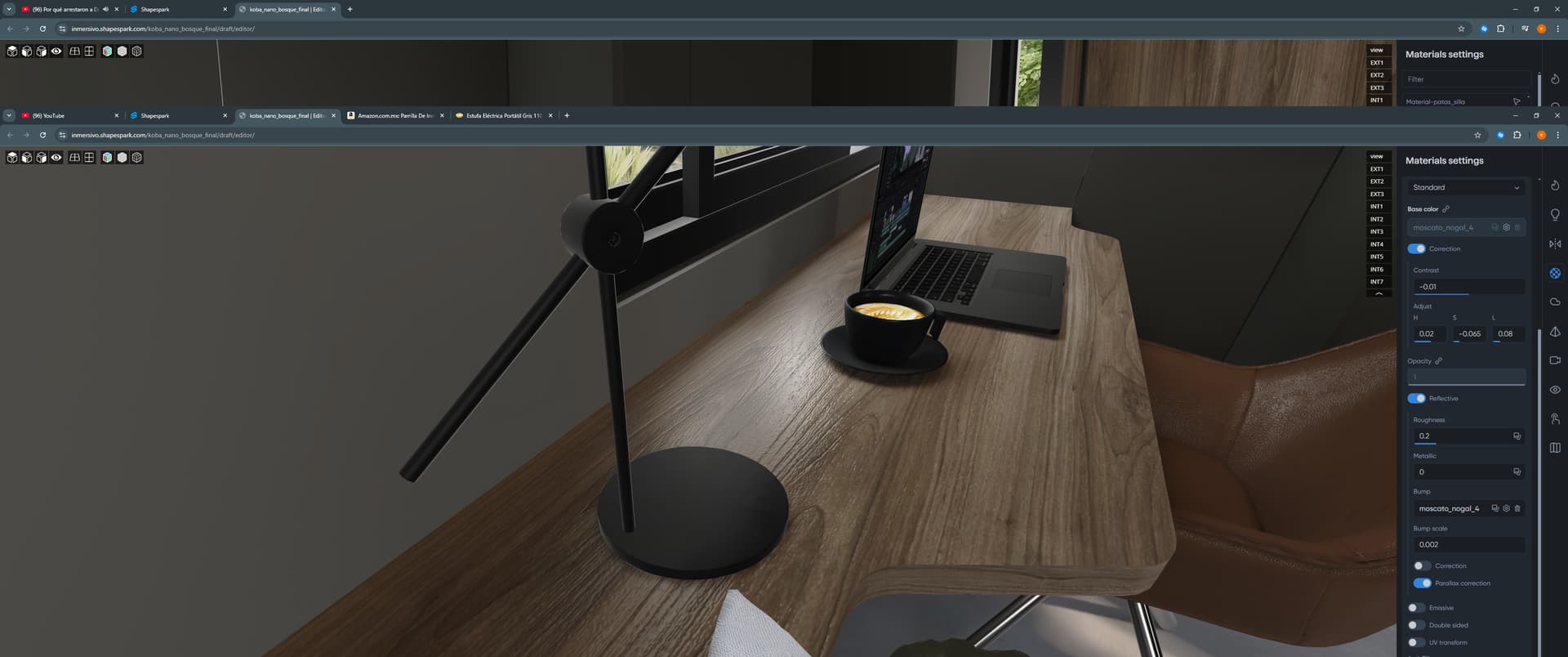

images during editing, before publishing the draft
images after publishing draft

Thanks for the detailed description. The issue is not related to the draft/published scene version, but to the sky being in HDR format. Shapespark doesn’t generate reflection probe images for HDR skies properly. When you added the sky texture there was no change in the reflections, because reflections probe images are not regenerated immediately. Only when you reloaded the scene (after publishing), the new reflection probe images were computed, with reflections being way too dark. We’ll be looking into this issue.
For now, please change your sky from HDR format to LDR format (jpg, webp), and the reflections should have proper strength.
