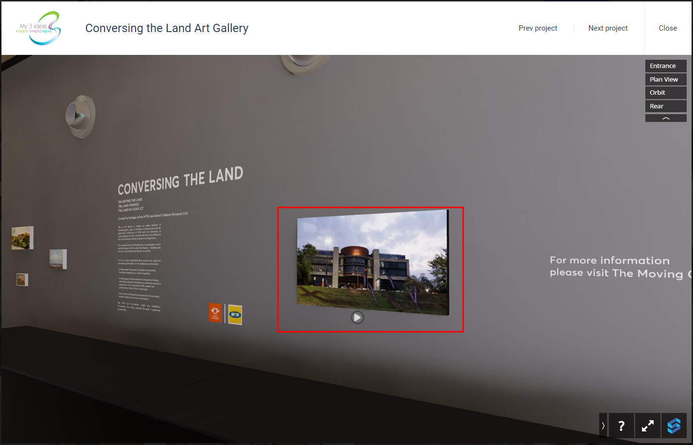

In [Conversing the Land Art Gallery] project, there is a play/pause function button.
How can I make like this?
And, is there a way that to embed a YouTube video in this format?

Hi
Video texture with a trigger to play and pause it’s one of our extensions video texture control
here you can find instructions how to set it up:
To add a video texture to the material you can just simply add video file as base color in the material.
Unfortunately it’s not possible to add YouTube video
