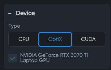

Are You using OptiX when baking the lightmap in Shapespark? OptiX should be quite fast.

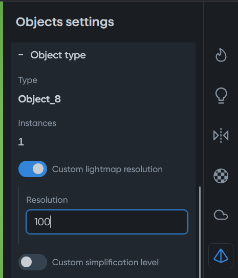

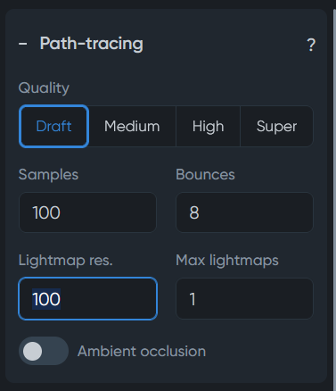

Have You tried increasing lightmap resolution? If the shadows are too blurry then this might help.
You can increase resolution for the whole scene:
Or even better only for objects which require better shadow quality:
Increasing resolution for the whole scene will be costly, but for selected objects should be fine.
It should give you a similar effect as if You would bake lighting in external program in higher resolution and imported it into Shapespark.
