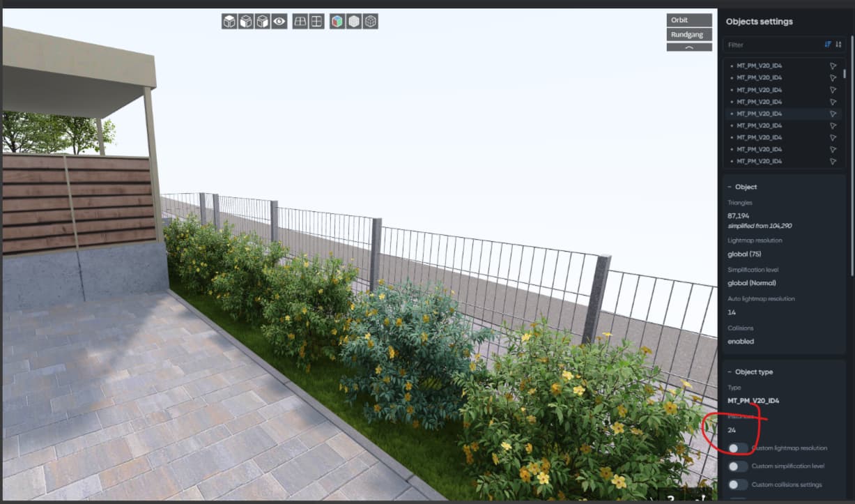

Hello.
I wanted to ask if the hashtag “#debugbuffers” works in Shapespark version 3.4.3?
Because I don’t see any instance objects when I add this hashtag.
But I do have instance objects in my object menu.

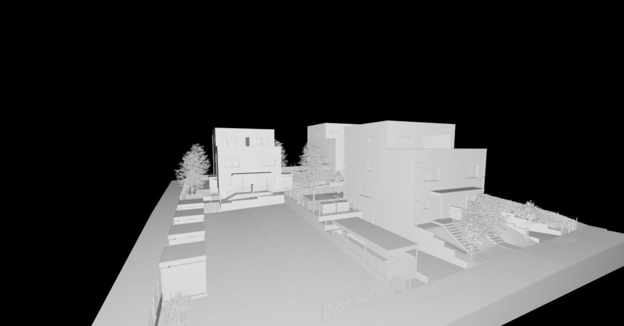

Out of curiosity, what is this command for and how do you use it?
It allows to find out which scene objects Shapespark has identified as identical. Geometry of such objects is stored only in copy and shared among all the clones, which reduces scene memory consumption.
