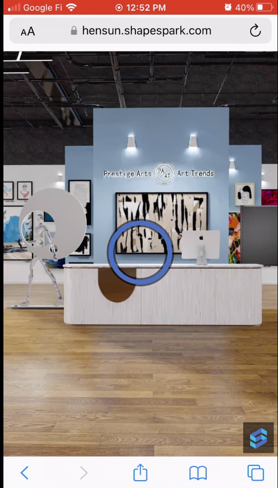

We recently built a virtual gallery https://hensun.shapespark.com/paatlv which works great in the desktop environment, however, we run into issue with iPhone. Please see attached screenshots.
We’ve managed to reproduce issue. Sometimes complex scenes can fail on mobile devices due to memory limitations. However, it seems in your scene main challenge for mobile GPU might be too high count of lightmaps. Could you try to limit max lightmap count to 4 or less?
