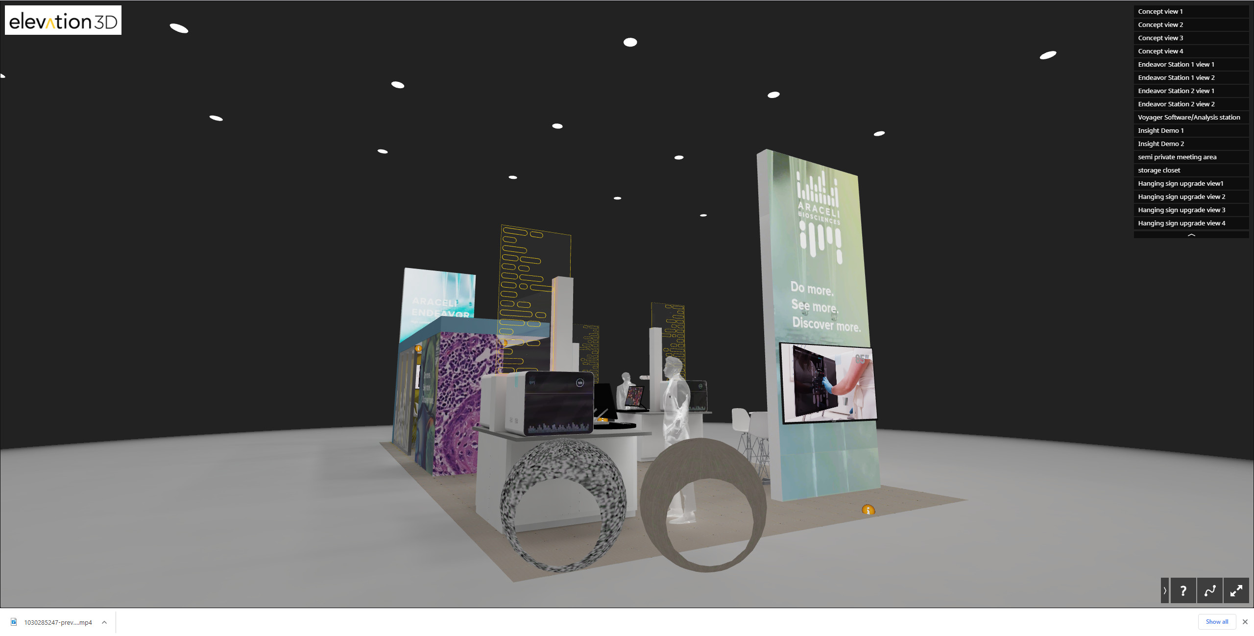

Materiel picker won’t change in the editor, just shows black
it works in the uploaded file though. but the sample spheres seem to be clipped

The second issue is a bug in how Shapespark calculates camera near plane in the orbit mode. If the camera is far from the orbit center the camera near plane is moved further away to prevent z-fighting, but in this case it is moved too far and the material picker spheres are clipped. We will work on a fix.
We have fixed the second issue.
