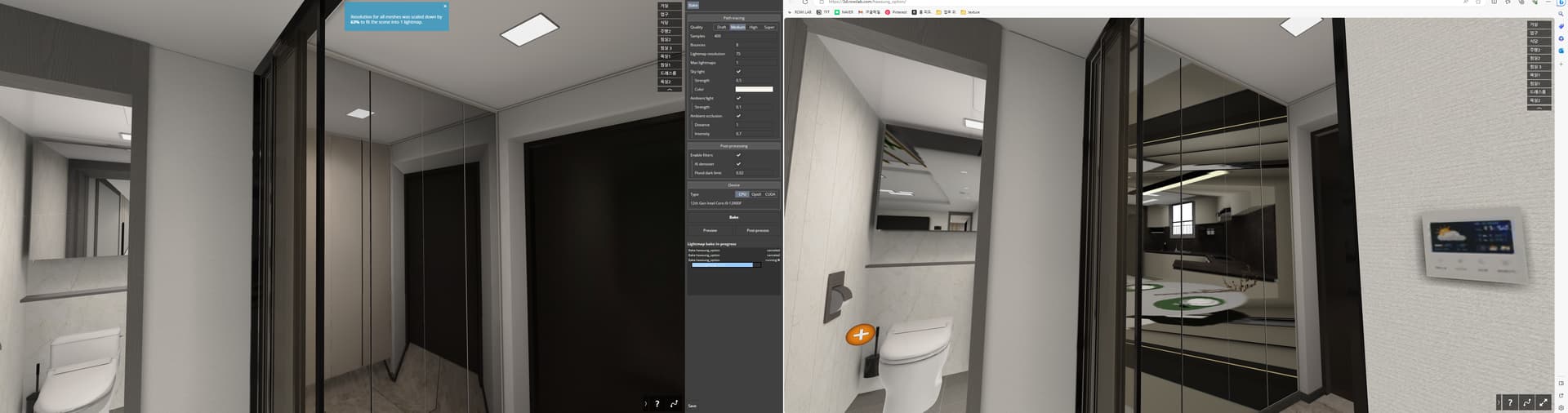

Mirror reflection value error
On the editor screen, the reflections on the mirrors are fine, but the link shows abnormal reflections
how can i fix it?
Tried clearing and redeploying light probes, but it didn’t work
We have a fix ready for an issue with reflections and it will probably solve your problem as well. We’re planning to release it next week.
If you send us the link to the problematic scene (or alternatively send the scene in a zip file) then we could make sure that this fix will work for your scene too.
