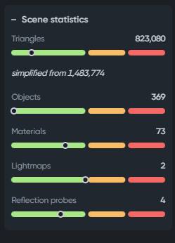

Hi, my build is not loading properly on mobile devices and laptops. There is an FPS drop, but I don’t know why. Everything in the Scene statistics shows green, yet it still lags on mobile. Please help me.this is the link 3D scene
hi, on which mobile device you’re experiencing the issue exactly?
in Android mobile and laptop. My laptop has a 4050 graphic card, but it’s lagging, while my system with a 3060 is working fine. I don’t know why.
Auto exposure is causing the issue in your scene. You can disable it in the Camera tab. After that, the scene should run more smoothly. Also, we’re planning to improve this feature in the near future, which will make auto exposure more optimized
It’s working properly now. Thank you, Magda you were very helpful!
