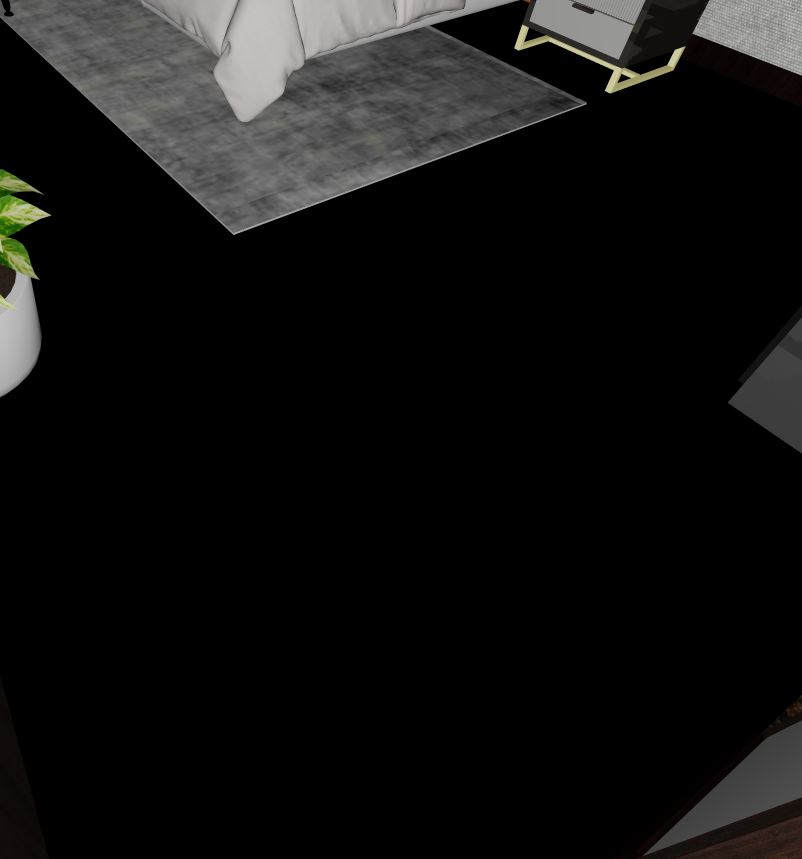

I export the Sketchup model to Shapespark.
One of flooring texture becomes totally black and when I do a test render, it disappears and I can see through the lower floor.
What did I do wrong?
It looks like a problem with face orientation. Please read more here: https://help.shapespark.com/hc/en-us/articles/360009249778-Some-faces-of-a-3D-model-are-not-visible-in-Shapespark
Thanks a lot. It is the face orientation issue. I fixed it.
