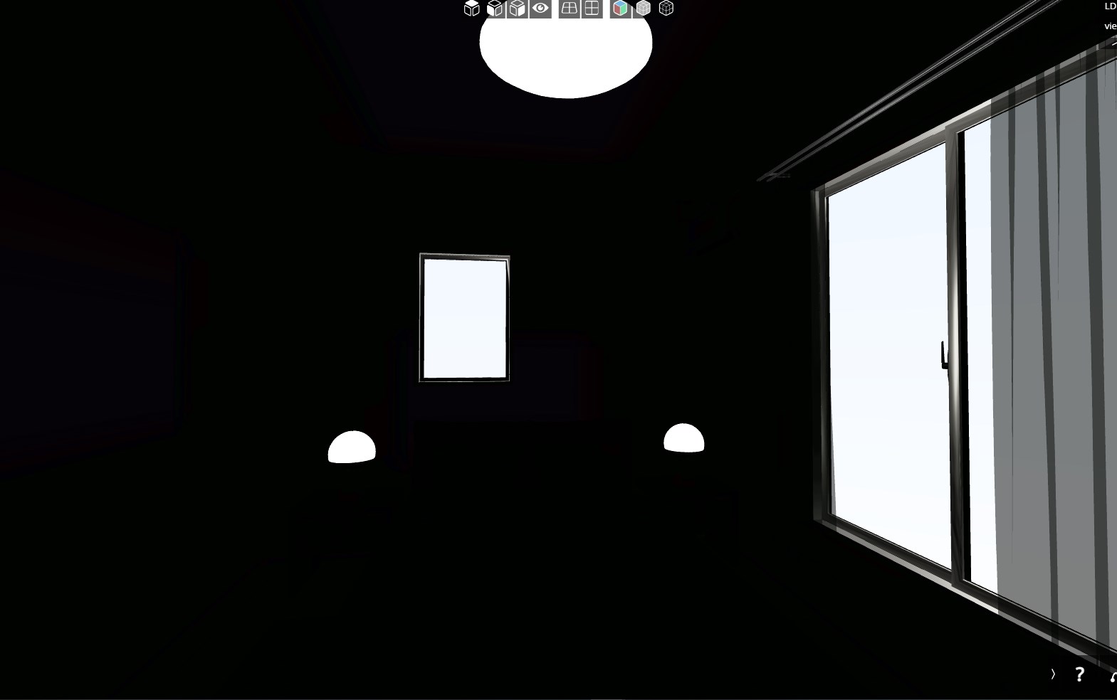

I just updated to version 3.4.1 and encountered this error. I tested it with all my files, and they all have the same issue. When I downgraded to version 3.1.1, baking worked fine again. Please help me with this issue. Thank you!
What is your GPU and GPU Driver version?
Minimum supported Nvidia GPU driver version is: 528.33
I think that if you update the driver to the latest version, baking should start working normally again.
