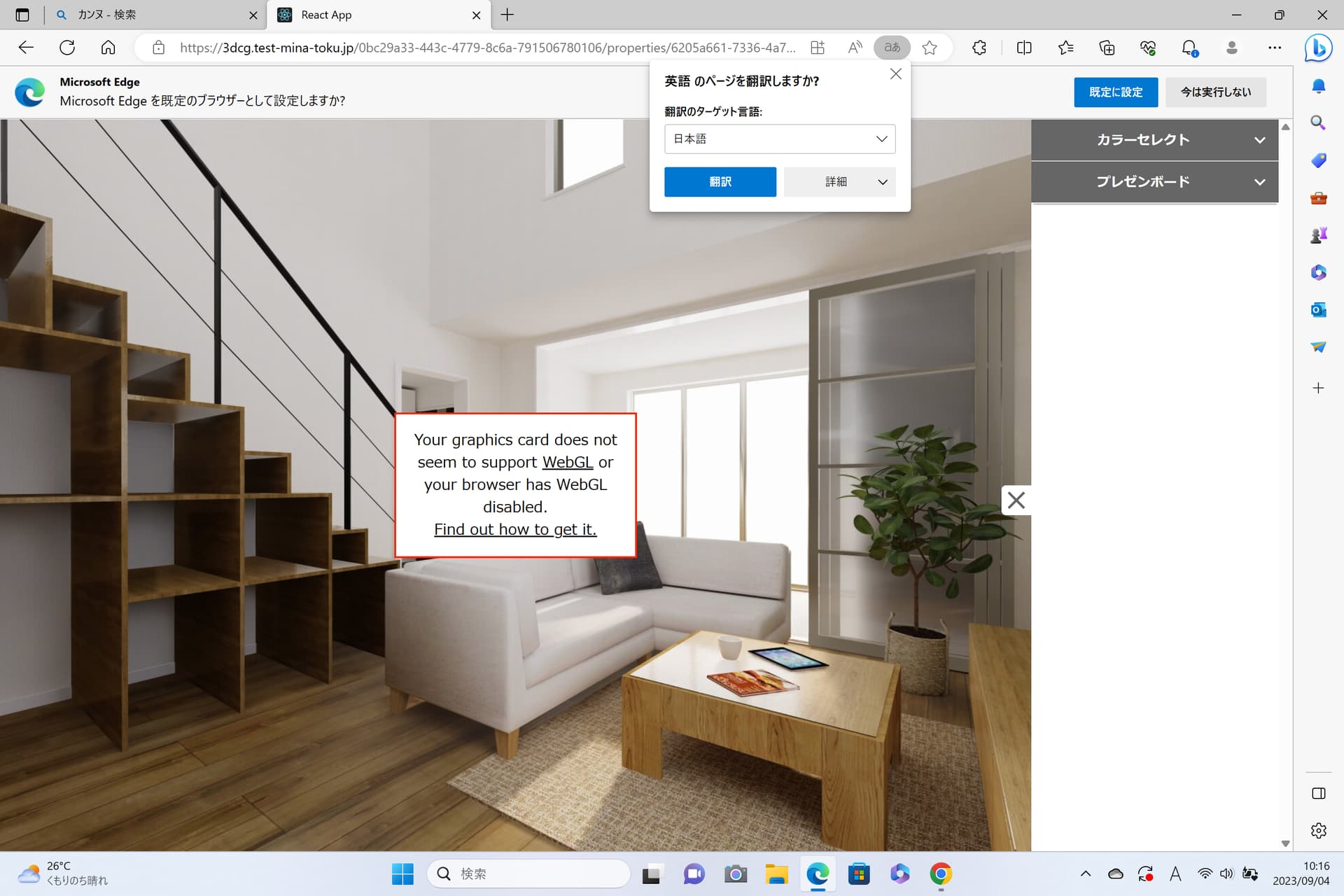

Please tell me about the WEB GL error.
We have issue with viewing a scene as attached.
This happens only I view with particular Surface Pro device.
Do you have any advise?

You can see 3 URLs.
I get an error when looking at the shapespark url.
A device that often causes errors is Surfacepro9.
https://www.microsoft.com/ja-jp/d/surface-pro-9/93vkd8np4fvk?activetab=pivot:概要tab
Is it possible that the graphics driver or RAM is weak and errors are likely to occur?
Please confirm.
I am very troubled.

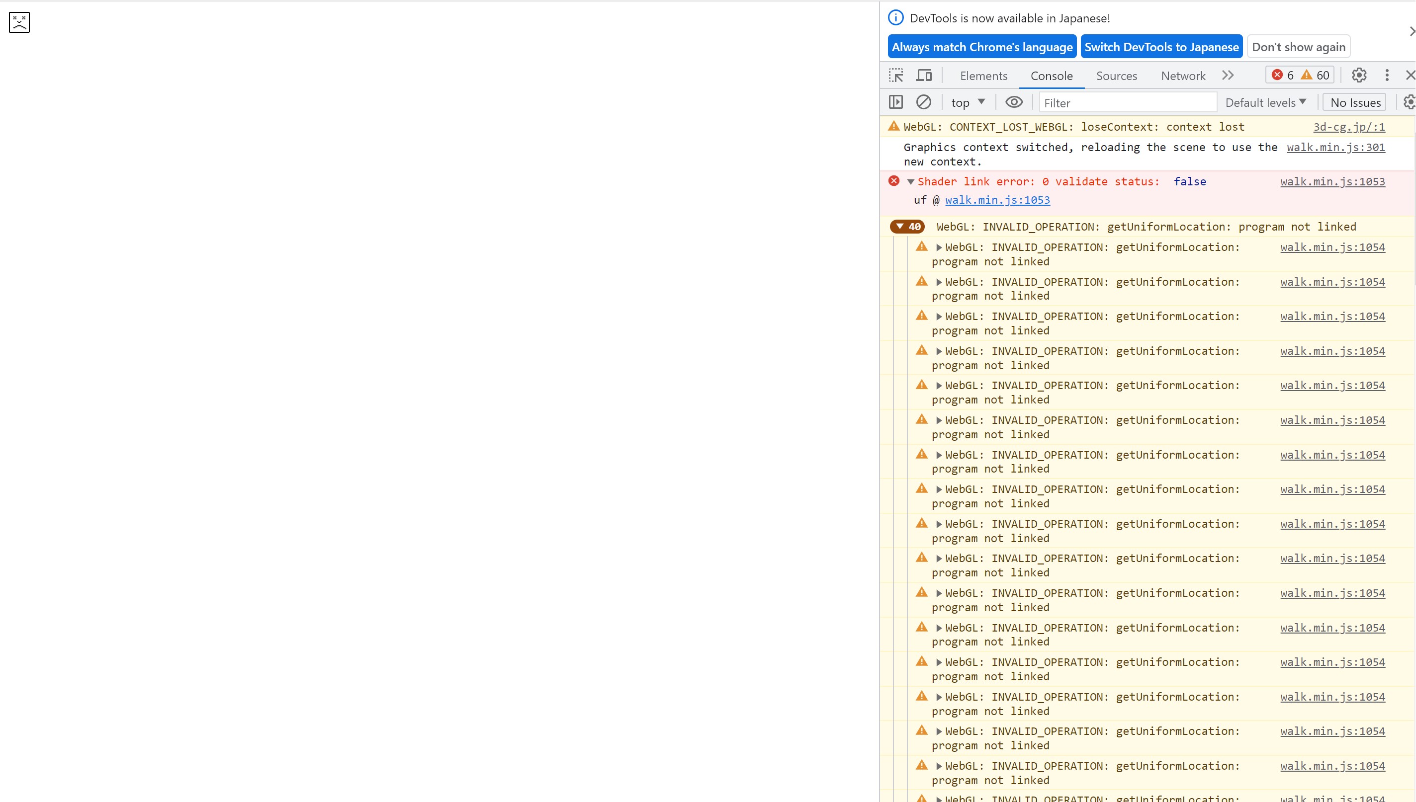

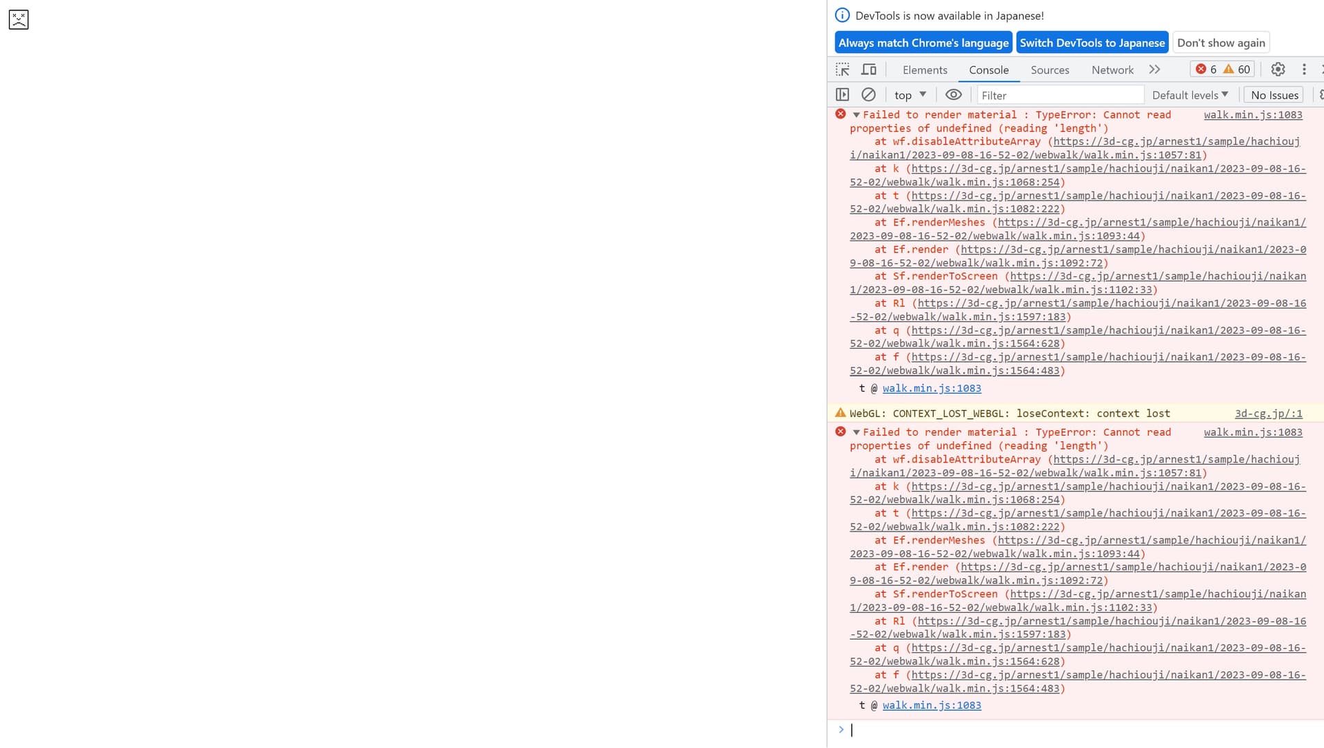

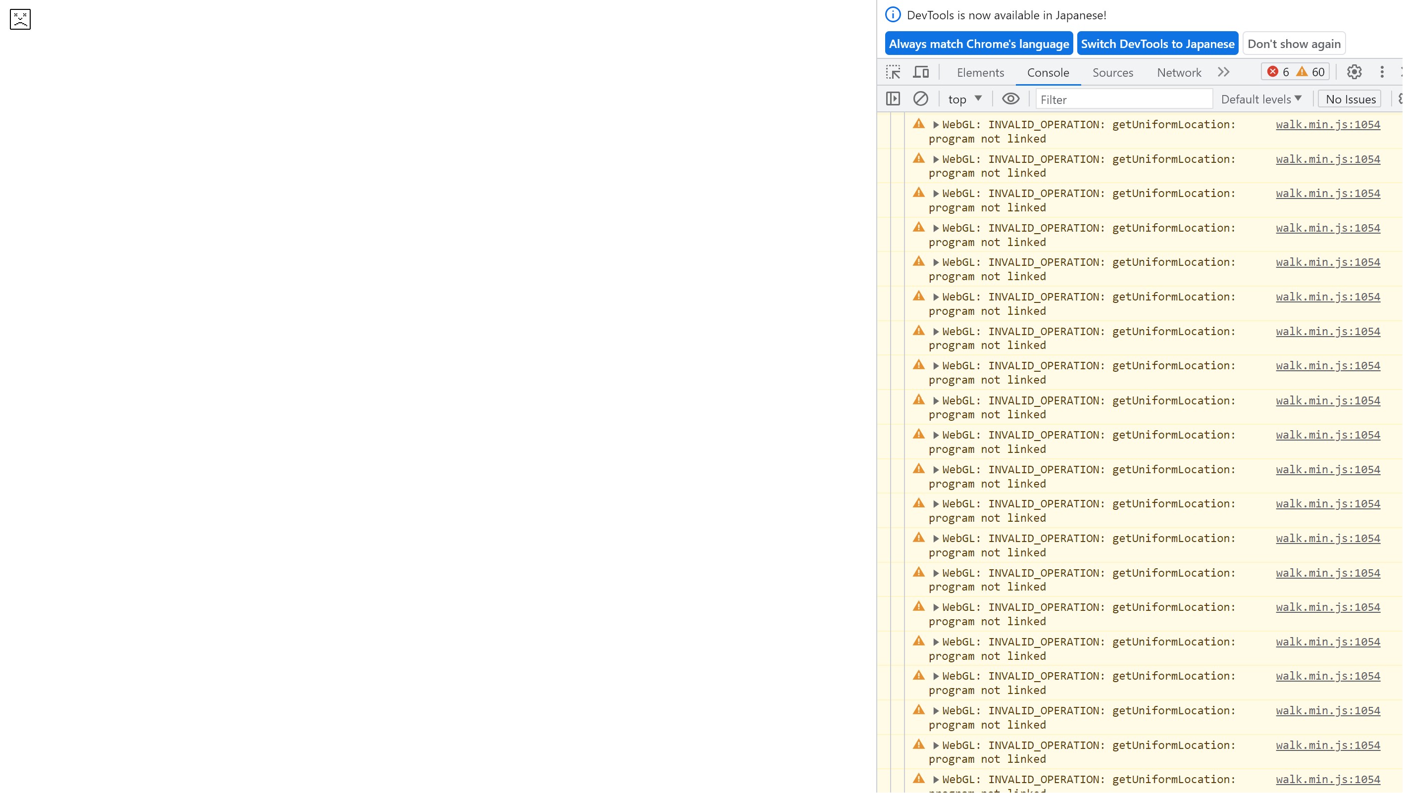

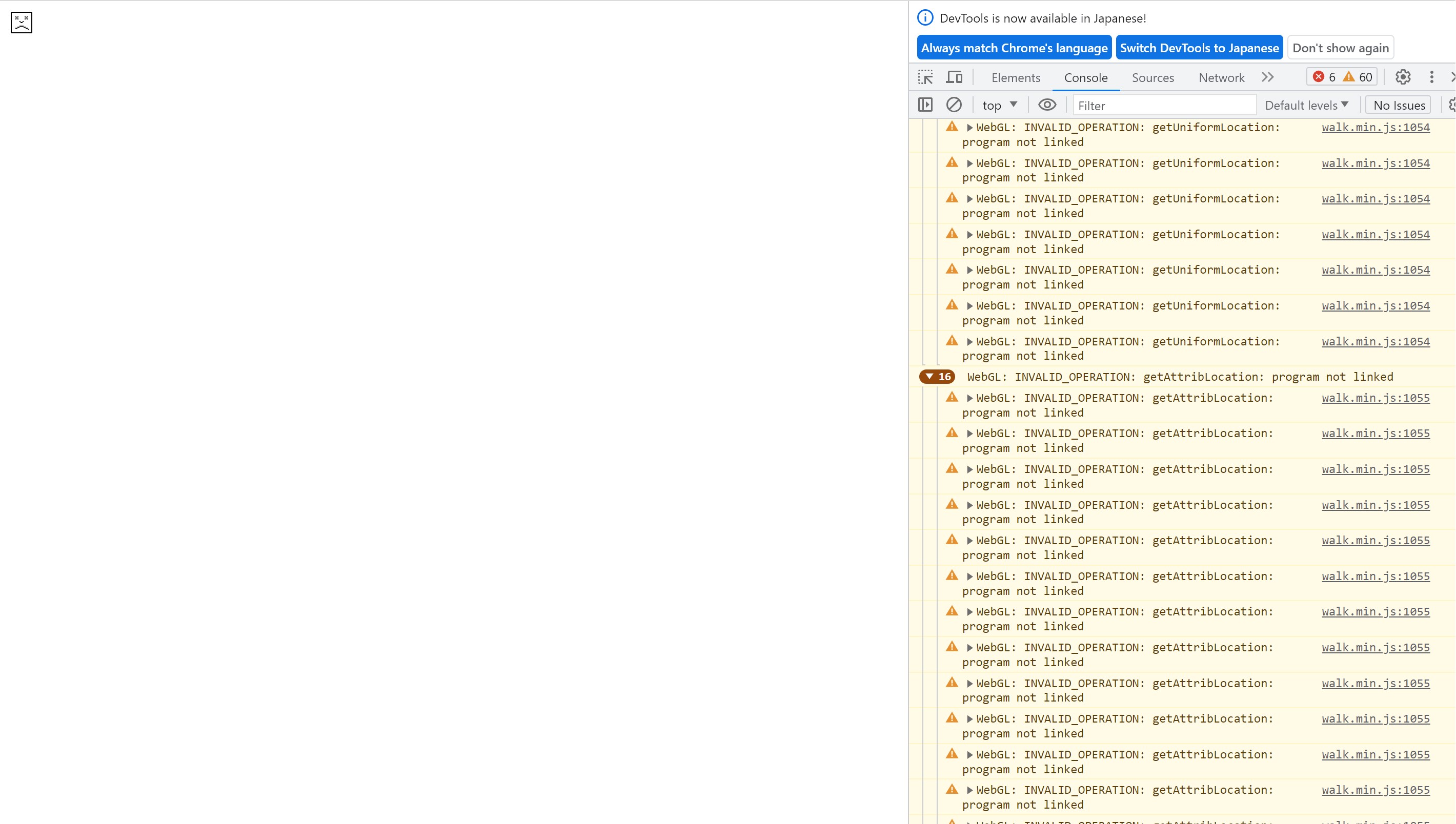

An error occurs when viewing this URL.
The error is a shader error as shown in the attached photo.
What is causing this problem?
please confirm.

Hi
We have narrowed the issue down to problem with gpu memory management either in chromium (chrome, edge) on Windows when using integrated graphic card or with intel driver itself. We have been able to reproduce browser crashing using other WebGL engine.
We have found out that scenes ran correctly when using Mozilla Firefox. I would suggest to give other browser a try if possible.
