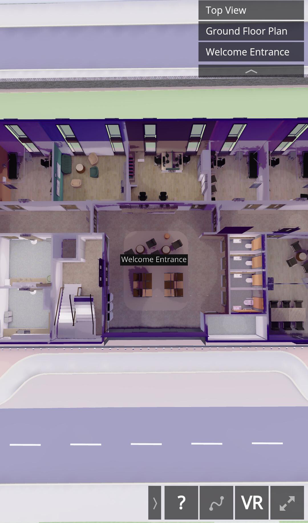

I wonder if somebody can help with advice, my scene looks good when viewing on the PC, however when viewed on a smartphone, there is a very strong purple tint.

Hello,

I have solved this but will keep the post up just in case.
The dark mode setting on my android created this issue.
Other scenes which I had created in the past with Shapespark were suddenly behaving in the same way, which turned my attention to my device rather than with Shapespark rendering itself.
Very usefull samantha thanks
i have extention who force some dark theme sometimes
