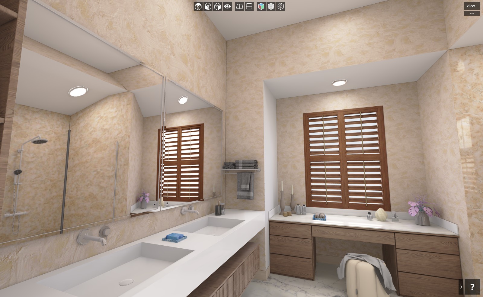

As one can see. Reflection in the mirror is not coming right. I tried changing the mesh of mirror object but same result. Please guide me , its urgent
Reflections in Shapespark use a fast, simplified technique so scenes can run smoothly on regular computers and mobile devices. Because of this, reflections aren’t always perfectly accurate. However, with some adjustments, you can usually make them look close enough for most projects.
Here you can read more about reflections in Shapespark and some tips how to make them better:
https://help.shapespark.com/hc/en-us/articles/6030218851601-Invalid-inaccurate-or-distorted-reflections
