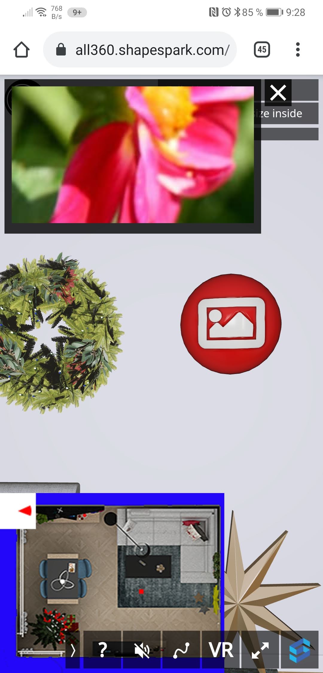

I have hosted several images in https://cloudinary.com/ and I generate the iframes with https://www.iframe-generator.com/. I copy and paste the result in the HTML extensions window and I can open them well but I can’t make the image fit into the iframe! Note: the iframe responds well to the size parameters by % but I need the image always to fit into the iframe, can someone explain me how I can do that?

This is the result of the tour you can see here
https://all360.shapespark.com/shapespark-example-room-christmas/
This is how it looks on PC
This is how it looks in Android
portrait
landscape
The iframe answer is correct but the image inside keeps its size, how can I make the image fit into the iframe and not have to use the scroll bars

@jorgearq, an easier way to embed an image is to use the <img> HTML element instead of <iframe>. In Shapespark viewer HTML label has a default style for <img> elements which makes their width & height adjust automatically to the viewport size (the image width takes 75% of the viewport width, and the image height is scaled to maintain the image aspect ratio).
Please use:
<img src=“https://res.cloudinary.com/arquitecto/image/upload/v1598376220/sample.jpg”>
instead of the <iframe ....></iframe> .
