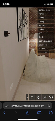

For whole houses, there’s parts where I get some serious shadows (attached) any recommendations to fix these? I’ve got the black filter on high to help but still get them.

How hight is the Flood dark limit setting in the scene with black splotches behind the sofa? You can try different values without baking the scene again, just use the Post process buton instead of the Bake button. This post could be also useful: Blotches and Burn Outs - #2 by wojtek
It’s still a work in progress so a few issues here and there but you can see the strange lighting behind the sofa. What is standard lighting practice? Spotlights for each individual downlight?
The Flood Dark Limit was set as high as it can go, but I can have a little play with this. I think maybe changing my area lighting might be the trick here if you can recommend the common practice alternative.
The strange lighting is the result of too high flood dark limit. If the filter is set to high it starts to affect normal shadows, not just areas that are dark as a result of too low lightmap resolution. Start with the default Flood dark limit value of 0.02 and increase it only if you see dark pixels leaking from behind the objects.
The darker the scene, the lower the limit needs to be, otherwise it affect the normal shadows.
