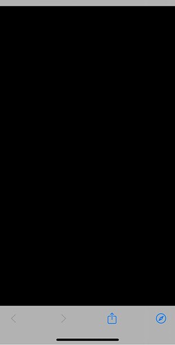

When updating to iOS 18.2 or later, there are devices where the scene becomes dark.
Hello,
When updating to iOS (iPadOS) 18.2 or later, there are devices where the scene becomes dark and cannot be rendered correctly.
It is likely dependent on GPU performance, but is it difficult to resolve this issue?
- iPad 9th generation, iPhone 11, iPhone SE2 (CPU: A13 Bionic)"

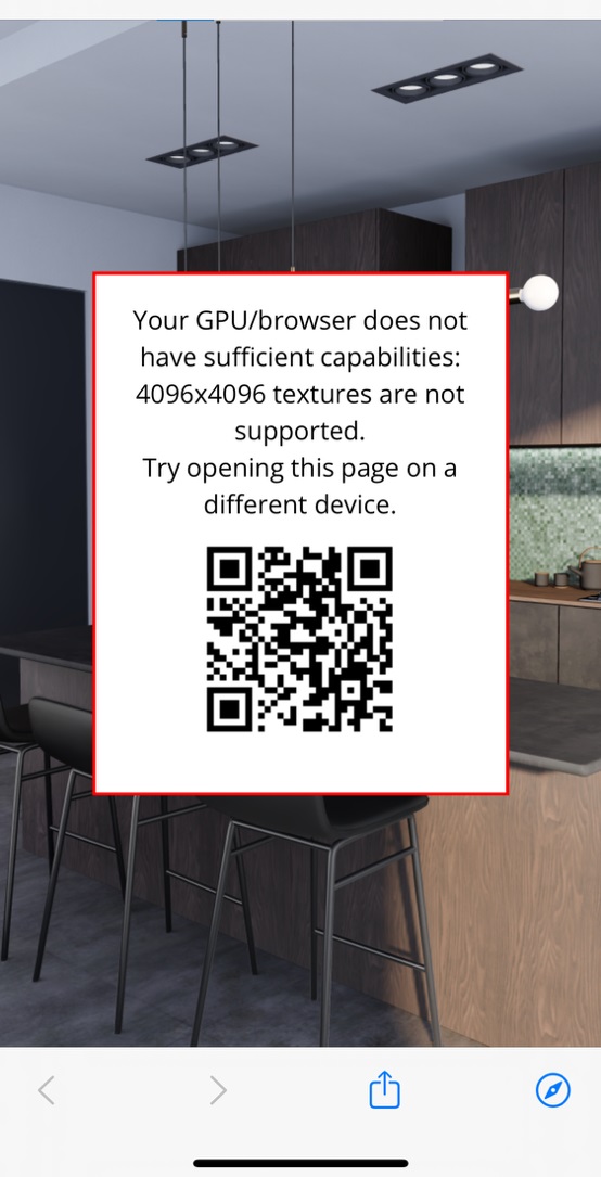

Just remember that once you get a black-screen on your browser, you have to restart it for Shapespark to start working again. Without restarting you will get a warning about missing GPU capabilities, as You’ve shown on the second screenshot.

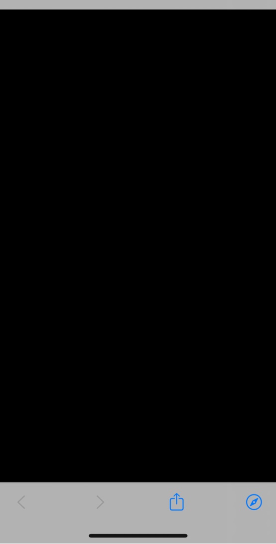

I tried changing the end of the URL and testing it, but the scene turned completely black.
However, any solutions that do not disable reflections would be very useful, so please continue to support us.
