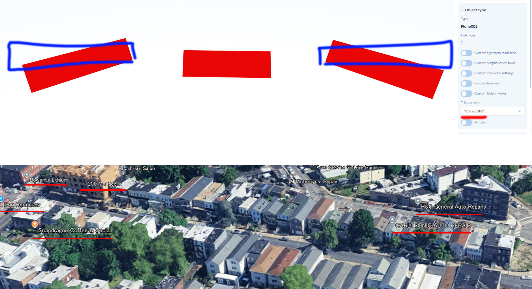

I want the object to be horizontal to the screen
When setting “Yaw & pitch” on an object, I would like it to be horizontal to the
screen, is this possible?
Like the text in Google Earth.
Yes, it should be possible, but may require adjusting initial object orientation (rotation). Could you share a link to the scene with us so we took a closer look at the issue?
Do you need it for arbitrary 3D object, or for text captions like in Room names in top and orbit views ?
Ideally, I would like to use a representation likeRoom names in top and orbit views, but I would like to hide some Views using
“Custom hide in views”.
