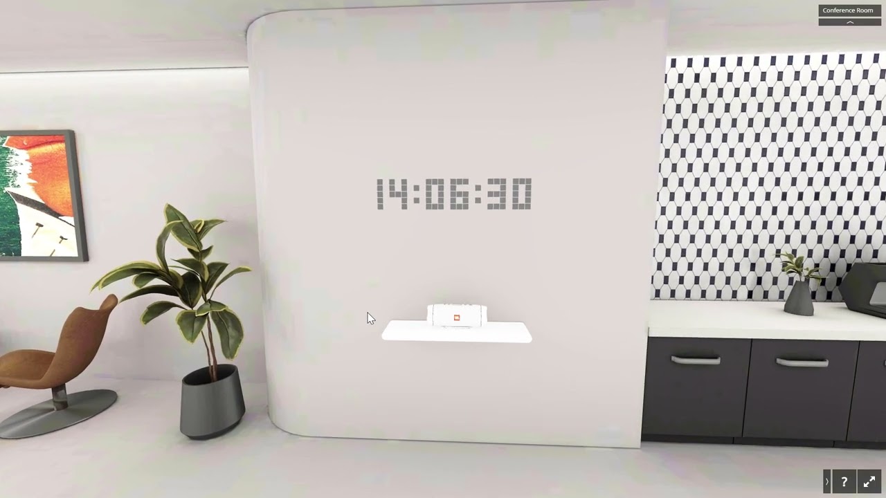

Our last experiment looked like this, we implemented now shapespark apps in more robust and clean react apps.
