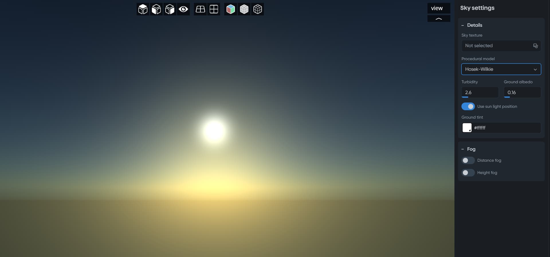

We are happy to announce that we have just released Shapespark 3.5.0!
It includes some brand-new features and several fixes:
  • Added procedural sky model and controls for sky appearance.
  • Extended UV transform with rotation.
  • Added experimental support for baking on AMD GPUs.
  • Allow to switch between VR scenes seamlessly in Meta browser.
  • Improved rendering performance when auto-exposure is enabled.
  • Added volume control to audio/video-related extensions.
  • Fixed meeting disconnection for a participant remaining in the meeting while others join or leave.
  • Fixed #debugbuffers flag.
  • Fixed clicks on material picker spheres not working, especially on mobile devices.
  • Improved orbit view camera pivot placement.
Especially the new procedural sky model is worth checking out:
